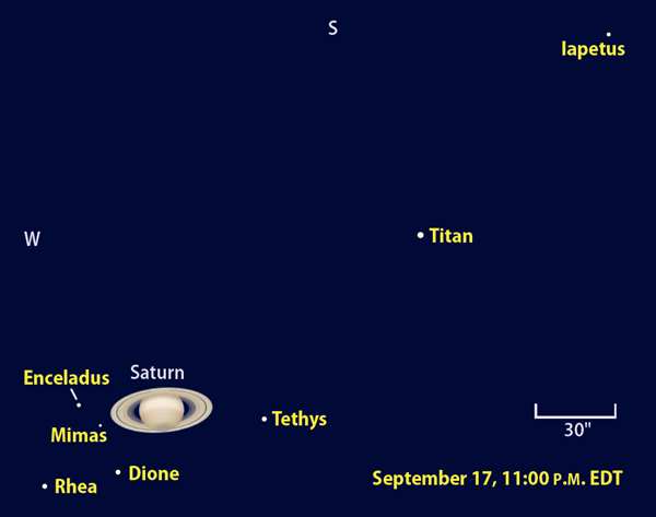

Modest scopes also reveal several of the ringed world’s moons. The brightest is 8th-magnitude Titan, an easy target through any scope. It approaches within 1.3′ of Saturn when it passes north (September 11 and 27) or south (the 3rd and 19th) of the planet. The moon strays up to 2.9′ from the gas giant at greatest eastern and western elongation.
While it takes Titan 16 days to orbit Saturn, five dimmer moons complete their circuits in less than five days. Tethys, Dione, and Rhea glow at 10th magnitude and show up through 4-inch scopes on any clear night.
To capture 12th-magnitude Enceladus or 13th-magnitude Mimas, you’ll need at least a 6-inch instrument with good optics. The former revolves around Saturn in 33 hours while the latter takes 23 hours. Both lie near the rings’ edge and often get lost in the glare. Your best bet is to look for them September 17, when they reach greatest western elongation within two hours of each other.
Coincidentally, the 17th is also the best evening to look for Iapetus, which takes 79 days to orbit Saturn. If you draw a line from Saturn to Titan and then extend it an equal distance, Iapetus will be right there. A 4-inch scope reveals this moon’s 11th-magnitude glow.

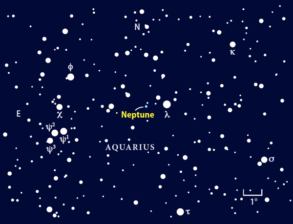

Grab your binoculars and center 4th-magnitude Lambda (λ) Aquarii in your field of view. In early September, Neptune lies 1.2° due east of Lambda. The planet’s westward motion brings it 0.7° southeast of the star by month’s end.
Neptune passes just 1′ south of an 8th-magnitude background star the night of September 18/19. Although the similarly bright objects may be hard to identify through binoculars, a telescope will tell you which is which. Only Neptune shows a distinct disk, which measures 2.4″ across and appears blue-gray.

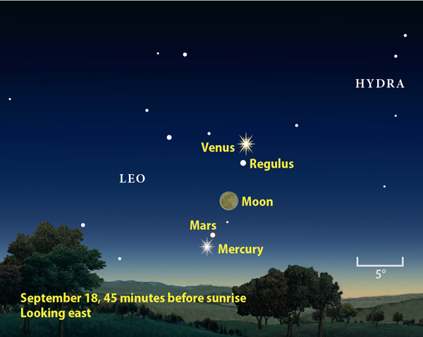

A waning crescent Moon adds to the scene on the 17th. The slim crescent hangs 6° above Venus with Leo’s brightest star, magnitude 1.4 Regulus, 3° below the planet. Mars and Mercury huddle 11° below Venus.
The solar system fireworks peak September 18. A wafer-thin crescent Moon then lies below Venus and above the Mercury-Mars pair, with just 1.5° separating the latter two planets. While Venus and Mars shine as brightly as they did earlier in the month, Mercury has improved to magnitude –1.0.

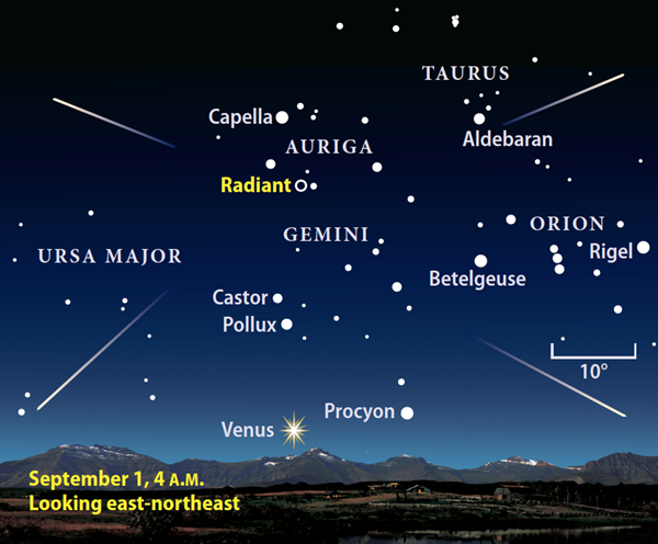

September is a quiet month on the meteor calendar. The best of the minor showers is the Aurigids, which peaks September 1. Although observers have noticed occasional bursts in the past century, astronomers don’t anticipate any this year. The best views should come shortly before dawn, once the waxing gibbous Moon has set and the radiant climbs high. Under a dark sky, observers can expect to see an average of six meteors per hour emanating from the constellation Auriga.

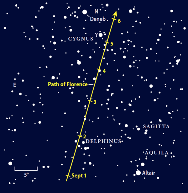

Asteroid 3122 Florence — named after British nursing pioneer Florence Nightingale — is perfectly placed for evening viewing from the Northern Hemisphere. It comes closest to Earth on September 1, when it sweeps within 4.4 million miles of our planet and appears among the background stars of eastern Delphinus. By the next evening, it has shifted into northern Delphinus. Florence moves at some 9° per day, which translates into 22″ per minute. (In comparison, Jupiter currently spans 32″.)
Florence glows at 9th magnitude on September’s first three nights and dims to 10th magnitude the following three nights. On the 5th, it sweeps 1° west of 2nd-magnitude Gamma (γ) Cygni, the central star of Cygnus the Swan. But by then its motion has slowed to nearly half of what it was at the beginning of the month.
