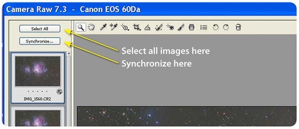

5. Pick one of the selected images by right-clicking on it. From the menu, choose “Open in Camera Raw.”
6. Here’s where you can have some fun. Take all the controls in “Camera Raw” and make your image look as good as you can, including doing spot enhancements with the “Adjustment Brush.” You can apply myriad tools including curves, noise suppression, and color and detail enhancements, just to name a few.

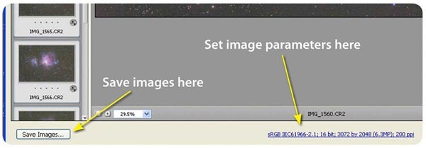

8. Under the master frame, you will see some data. Click on it. Here you will set the color space, bit depth, size, and resolution of your saved image.
9. Once you have specified these parameters, click “Save Images” in the lower left corner. Here you will designate the file name, the destination folder (for me, it’s M42), and the file format.
10. When you click “OK,” “Camera Raw” will save every one of the enhanced images into your new folder.
