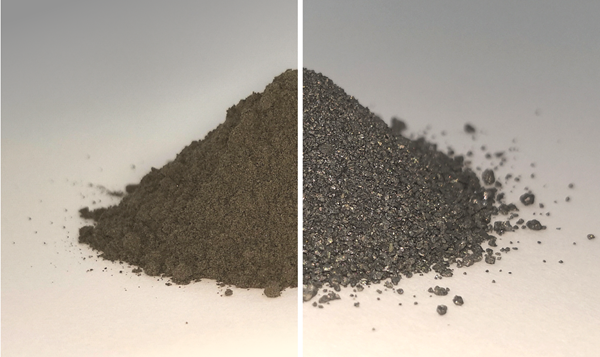

To separate the oxygen from other components in faux Moon rocks, the researchers use a technique called molten salt electrolysis.
By first placing the powdery Moon dust into a hot batch of molten calcium chloride salt, then running an electrical current through the mixture, the researchers can let chemistry and physics do the heavy lifting. The oxygen previously trapped in the simulated rocks migrates to an electrode (specifically, an anode), where the researchers can then capture it.
With this technique, the researchers report, they have been able to pull 96 percent of the oxygen out of their imitation Moon rocks in the course of just 50 hours. Alternatively, they can extract 75 percent of the oxygen in just the first 15 hours. Plus, as an added bonus, the process leaves behind a mixture of metal alloys that researchers suggest could be useful as well.
