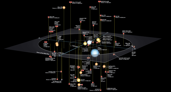

The nearest stars
Two-thirds of our stellar neighbors are cool M-class dwarf stars. The remaining third is a mixture of white dwarfs; type K, G, F, and A main sequence stars; and a handful of T- and L-class brown dwarfs. The stars’ sizes are scaled relative to each other, not to the distances between them. All stellar data are from the Research Consortium on Nearby Stars (RECONS).

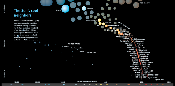

But that’s not the astonishing part. Within 15 light-years, no high-mass class O or B stars exist. The closest B star — Regulus — is 79 light-years away, and the nearest O star is nearly 400. Neither does our designated sphere contain giants or supergiants. At 34 light-years, the nearest giant is Pollux. The closest supergiant, Betelgeuse, lies at an uncertain 400 light-years. Every star within 15 light-years from the Sun is a dwarf!
We do, however, see a run-of-the-mill A star, Sirius, the brightest star in the night sky. It lies 8.6 light-years away and has 22 times the visual solar luminosity. One cooler F star, Procyon, is 11.4 light-years away and is at least on its way to becoming a giant.

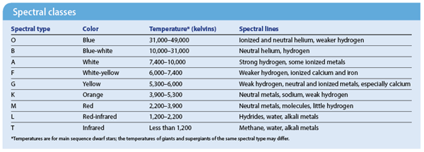

The cooler the stars we look at, the higher the numbers. Our neighborhood has three G-class stars: the Sun, the brightest member of the Alpha Centauri system, and Tau Ceti (11.9 light-years). Next cooler is the K class, which contains eight stars. This group includes the second-brightest member of the Alpha Centauri system and the 61 Cygni double — the first stars whose distances (11.4 light-years) were known. In fact, the 61 Cygni system contains the coolest main sequence stars bright enough to be seen with the naked eye (you still need a telescope to resolve them from each other).
About two-thirds of nearby stars — 49 of them — are cool M-class red dwarfs with masses under half the Sun’s. Not one of these stellar microbes is visible to the naked eye: The brightest glows at 7th magnitude. The nearest star to us belongs to this class: 11th-magnitude Proxima Centauri, the third member of the Alpha Centauri triple. This star is on the sunward side of its million-year orbit about the inner pair, and is, thus, about 10,000 astronomical units (AU; the distance between the Sun and Earth) closer to us, or 250 times the Sun-Pluto distance, than the brighter pair.

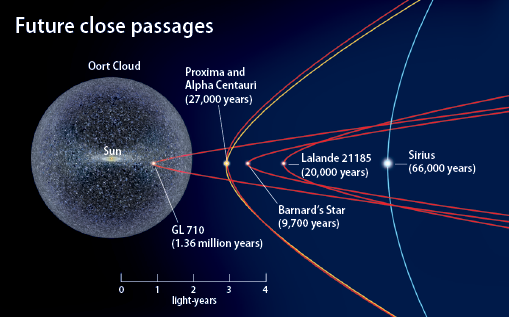

Many nearby stars will pass close to the Oort Cloud, but only one will move through it. In 1.36 million years, Gliese 710 likely will gravitationally perturb millions of comets, sending a sizable number on a potential collision course with Earth.
