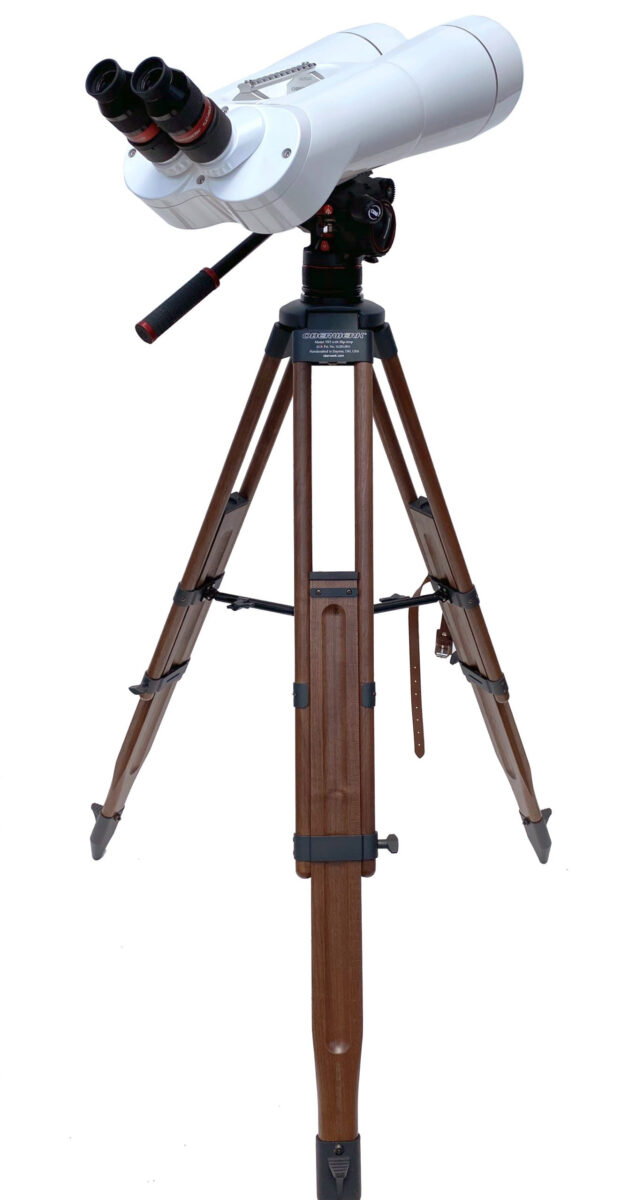

You can purchase the binoculars with a variety of support structures. The classic is a wooden tripod with an elevation bar and swivel that the binoculars bolt to. The more advanced system I used is one of Oberwerk’s heads that sits on a Manfrotto 161MK2B tripod, which has a crank-operated elevator that can raise the binoculars to nearly 9 feet (2.74 meters). It’s a solid little mount that holds the binoculars with no vibration.
Even with two 5-inch triplet objectives and massive prisms, the magnesium alloy construction keeps the weight of these binoculars at just 24 pounds (10.9 kilograms). I have no trouble setting them up by myself.

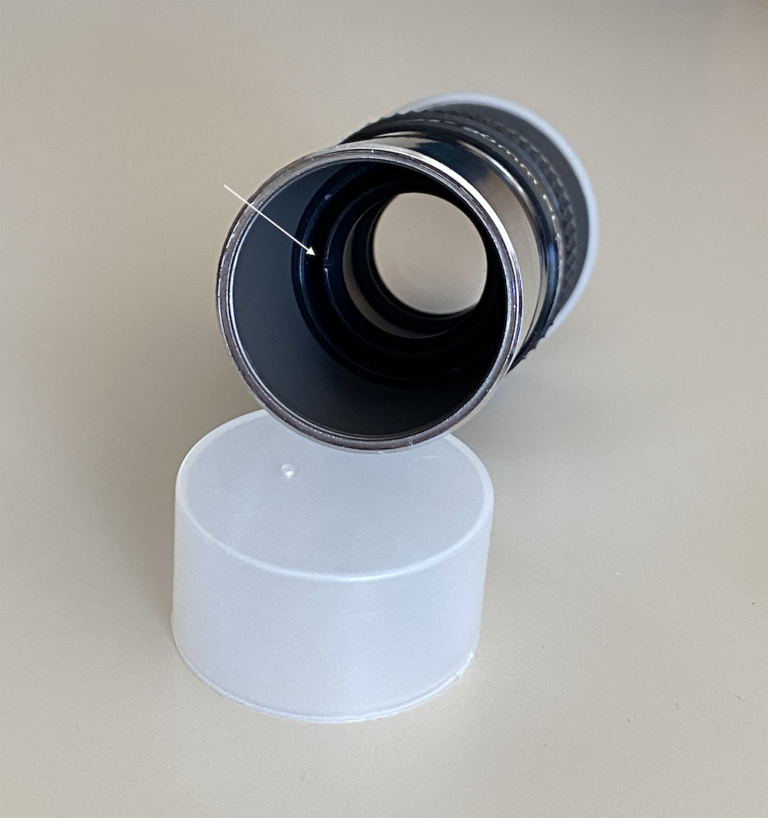

Let’s talk about the eyepieces and visual experience offered by these 5-inch binoculars, which come with Oberwerk 14mm (46x) 70° apparent field of view eyepieces. You can also buy 22mm (30x) and 7mm (93x) eyepieces to create a versatile set. The company sells each pair for $319.95. The eyepieces lock in place with a thin ring that sits on top of the much deeper focusing ring. You focus each eyepiece individually.
