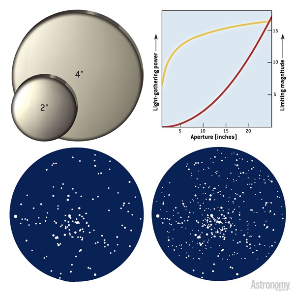

A telescope’s main purpose is to collect light. This property of telescopes allows you to observe objects much fainter than you can see with your eyes alone. Galileo said it best when he declared that telescopes “revealed the invisible.”

Light-gathering power: Why “bigger is better”: A 4-inch-diameter mirror has four times the light-gathering area of a 2-inch-diameter mirror. A larger scope gathers more light, so you can observe fainter objects. The faintest star you can see through your telescope — “limiting magnitude” — depends on the size of the objective. A star field is shown above through a 2-inch (bottom left) and a 4-inch (bottom right).

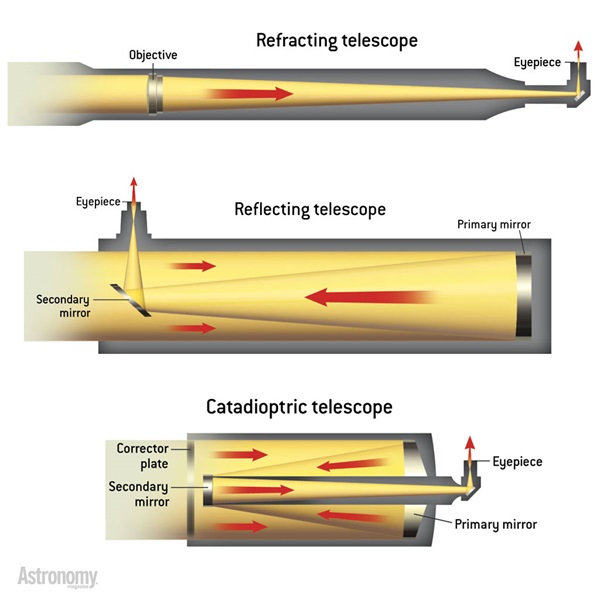

Telescope types
The three main types of telescopes use lenses, mirrors, or a combination of both.
Refracting telescopes use lenses — combining at least two, and as many as four, pieces of glass — as their objective (the primary light-gathering device).
Reflecting telescopes use mirrors to gather and focus light. In a Newtonian reflector — the most common type — light reflects from the primary mirror (whose surface is ground into a parabola so light comes to a common focus). The light strikes a smaller, flat secondary mirror near the top of the tube. The light then is bent 90° and enters the eyepiece through a small hole in the tube.
Catadioptric, or compound, telescopes incorporate a primary mirror coupled with a corrector lens placed at the front of the tube. The primary mirror’s curve is ground to a simple shape, usually a sphere. Ordinarily, a spherical mirror would introduce aberrations in the viewed image, but the corrector of a catadioptric scope “pre-bends” the light before it strikes the mirror. Two popular catadioptric telescopes are the Schmidt-Cassegrain and Maksutov-Cassegrain designs.
