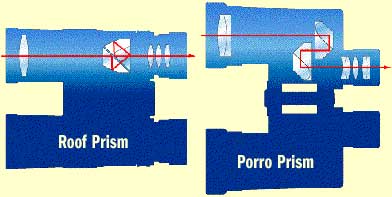

Binocular Prism Designs
Light bounces differently through binoculars according to the juxtaposition of the prisms. Porro-prism binoculars are generally preferred for astronomical use because they provide total internal reflection.
Rick Johnson
Binoculars contain a complex set of prisms that fold the light path internally and make the image appear right-side up. These prisms come in two varieties: roof and porro. Roof-prism models have straight barrels and are more compact. However, they tend to be more expensive and produce slightly dimmer images, making them less desirable for astronomical pursuits. Porro-prism binoculars have a zigzag shape and usually are heavier and bulkier than roof-prism models. Most higher quality binoculars are made of barium crown glass (BaK-4) instead of borosilicate glass (BK-7). Also, look for coated optics — the more lens and prism surfaces to which special coatings have been applied, the brighter and higher contrast the images will be.
