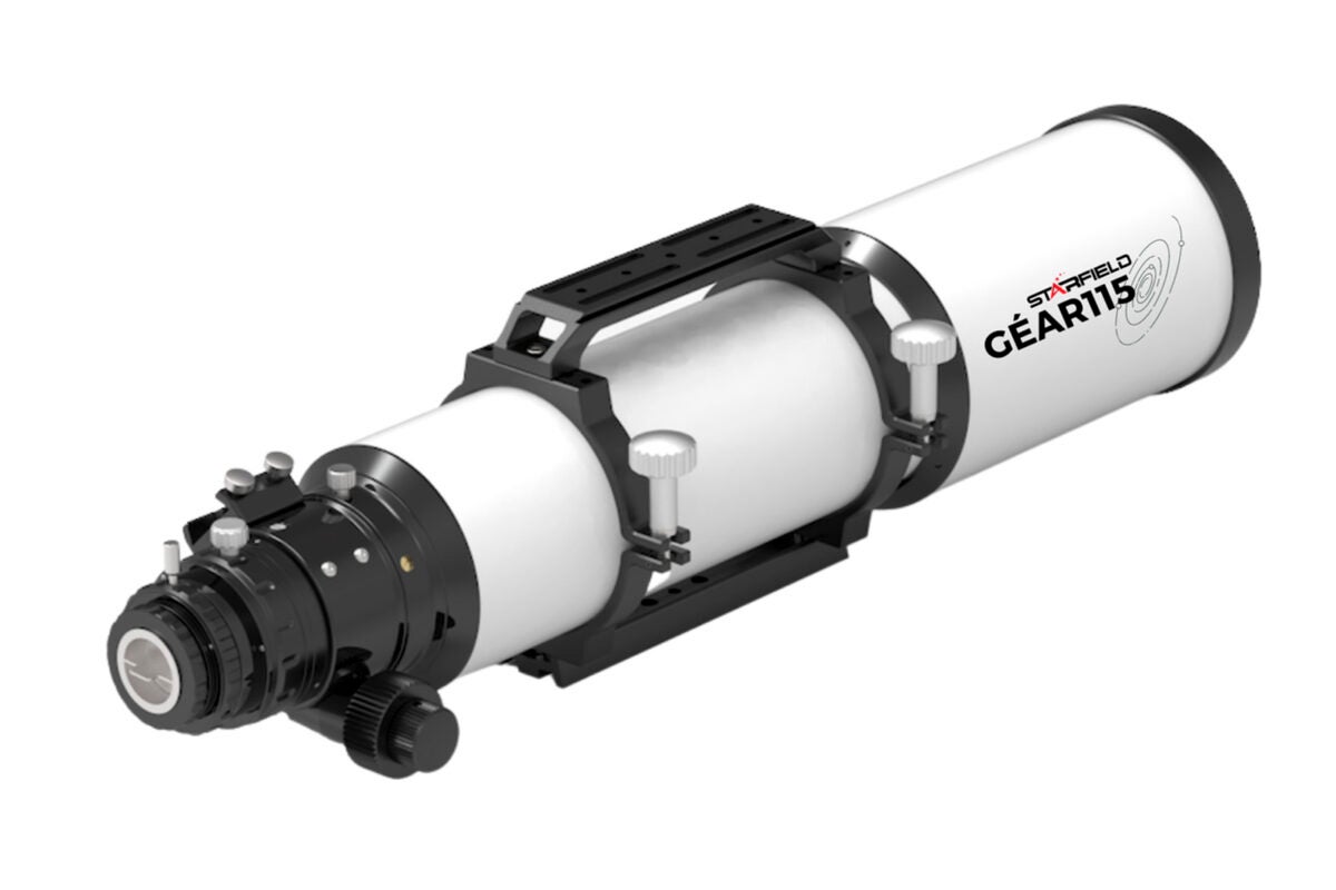

The telescope arrived safely directly from the manufacturer nestled in a foam-lined case inside a thick cardboard box. As soon as I unzipped the case and pulled out the optical tube assembly, I could tell that this was a well-built instrument.
The tube itself is made from high-quality aluminum, which delivers a solid feel while keeping the weight manageable. The tube measures approximately 28 inches (710 millimeters) long with the extendable dew shield stowed, and 35 inches (890 mm) when the shield is extended. The tube assembly weighs 15 pounds (6.8 kilograms), light enough to carry to remote locations.
The heart of the Géar 115mm is its triplet apochromatic objective lens, which significantly reduces chromatic aberration (the color fringing around bright objects). The result is sharp images with excellent color fidelity. The lenses are fully multicoated, which enhances light transmission and minimizes internal reflections. Staring through the objective and into the aluminum tube shows the interior is fully blackened. Four internal baffles minimize stray light from intruding into the optical path.

Besides exceptional optics, this refractor also includes mechanical features valued by visual observers and imagers. The dual-speed 2.5-inch rack-and-pinion focuser, with its included adapters, accepts both 1¼” and 2″ eyepieces and star diagonals. The focuser’s movement was smooth and responsive with no backlash. Its 10:1 reduction gearing makes it easy to achieve focus. The focuser is also fully rotatable and can be outfitted with optional motor control.
The Géar 115mm includes nicely machined CNC heavy-duty tube rings and a Vixen-style dovetail bar for easy mounting on a wide range of equatorial and alt-azimuth mounts. A second beam across the top of the rings serves as a carrying handle. It also has five tapped holes. The center hole has a ¼”-20 thread, while the others are M6 metric threaded. Additionally, the telescope’s focuser incorporates a standard Synta-style finder scope mounting shoe.
