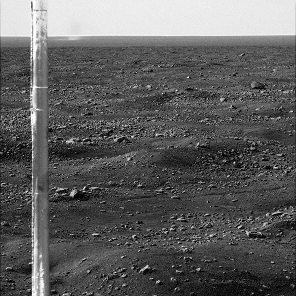

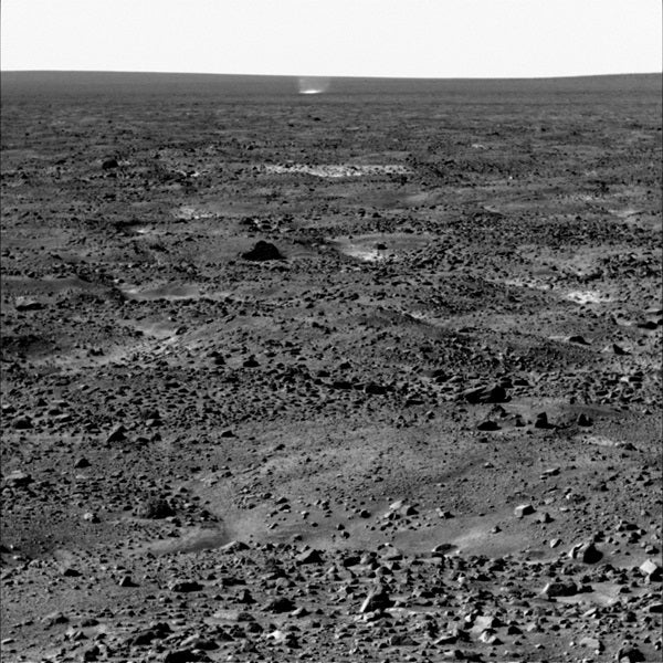

The Surface Stereo Imager camera on Phoenix took 29 images of the western and southwestern horizon on September 8, during mid-day hours of the lander’s 104th martian day. The next day, after the images had been transmitted to Earth, the Phoenix science team noticed a dust devil right away.
“It was a surprise to have a dust devil so visible that it stood with just the normal processing we do,” says Mark Lemmon of Texas A&M University, lead scientist for the stereo camera. “Once we saw a couple that way, we did some additional processing and found there are dust devils in 12 of the images.”
At least six different dust devils appear in the images, some of them in more than one image. They range in diameter from about 7 feet (2 meters) to about 16 feet (5 meters).
