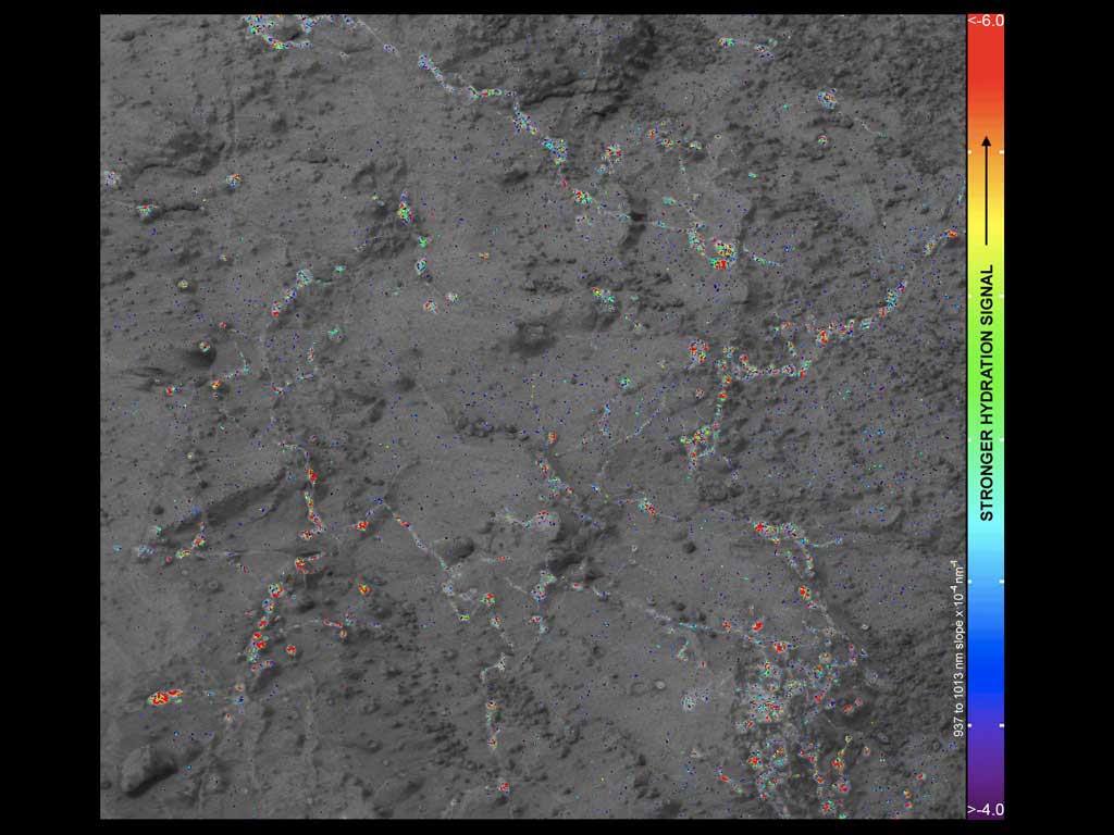

On this image of the rock target “Knorr,” color coding maps the amount of mineral hydration indicated by a ratio of near-infrared reflectance intensities measured by the Mast Camera (Mastcam) on NASA’s Mars rover Curiosity. // NASA/JPL-Caltech/MSSS/ASU

The rover’s Mast Camera (Mastcam) also can serve as a mineral-detecting and hydration-detecting tool, reported Jim Bell of Arizona State University in Tempe. “Some iron-bearing rocks and minerals can be detected and mapped using the Mastcam’s near-infrared filters.”
Ratios of brightness in different Mastcam near-infrared wavelengths can indicate the presence of some hydrated minerals. The technique was used to check rocks in the “Yellowknife Bay” area where Curiosity’s drill last month collected the first powder from the interior of a rock on Mars. Some rocks in Yellowknife Bay are crisscrossed with bright veins.
“With Mastcam, we see elevated hydration signals in the narrow veins that cut many of the rocks in this area,” said Melissa Rice of the California Institute of Technology in Pasadena. “These bright veins contain hydrated minerals that are different from the clay minerals in the surrounding rock matrix.”
