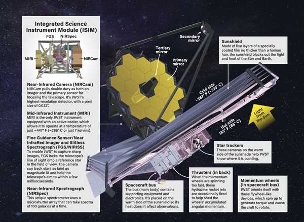

Webb is not just a bigger version of Hubble: It will be kept cold, so it does not emit infrared radiation. That means that, unlike Hubble, the telescope cannot be enclosed — it must be open to space with its components exposed so it can maintain a low temperature without an active cooling system.

JWST’s instrument suite covers the whole infrared wavelength range — from 0.6 to 28.8 microns — with imaging cameras, spectrometers, and a fine-guidance camera. All the instruments are passively cooled to −387 degrees Fahrenheit (−233 degrees Celsius, or 40 kelvins). The exception is the Mid InfraRed Instrument (MIRI), a camera and spectrograph that requires active cooling to −447 F (−266 C, or 7 kelvins).
The Webb’s Near Infrared Spectrometer (NIRSpec) can take spectra of 100 galaxies at a time by using tiny shutters that only let in the light from target objects and block everything else. Spectroscopy breaks light apart into its full spectrum like a prism, allowing us to identify different elements absorbing or emitting light at various wavelengths. From these spectral signatures, we can determine the chemical composition, the temperatures, and the motions of these targets. Spectroscopy puts the “fizz” in astrophysics.

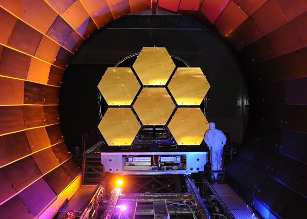

Then, Ball Aerospace in Colorado mounted the mirrors and began a series of optical tests. These continued in Alabama at NASA’s Marshall Space Flight Center (MSFC), where Ball used a cryogenic vacuum chamber to measure the tiny distortions the mirrors will experience in the coldness of space. After post-processing back in Colorado, the mirrors received their final polishing in California — performed precisely, to correct for the measured cryo-distortion. After another stop in Colorado to be cleaned, the mirrors were sent to New Jersey to be coated with gold.
After Ball remounted the mirrors in Colorado and carried out more cryogenic checks at MSFC, the finished mirrors traveled to NASA’s Goddard Space Flight Center in Maryland, where the telescope was assembled. More cryogenic tests to the entire telescope were performed at NASA’s Johnson Space Center in Houston. Then, the telescope was shipped to California, where Northrop Grumman completed final assembly, attaching the telescope to the sunshade and spacecraft. — Mark Zastrow

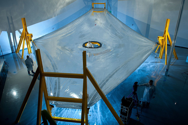

Ensuring the observatory will unfold properly has required an extremely thorough test program, since we currently have no ability to visit L2 for repairs. To that end, the observatory is designed with electronic redundancy wherever possible — there are two ways to turn on every motor or to set off the release mechanisms that hold everything in place for launch.
