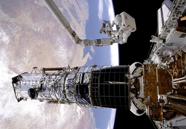

Hubble telescope undergoing astronaut repairs on first servicing mission
Astronauts repair the Hubble Space Telescope during the first servicing mission to the observatory in 1993, flown by the space shuttle Endeavour.
