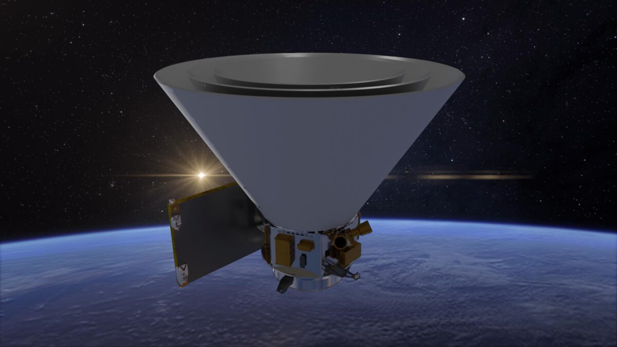

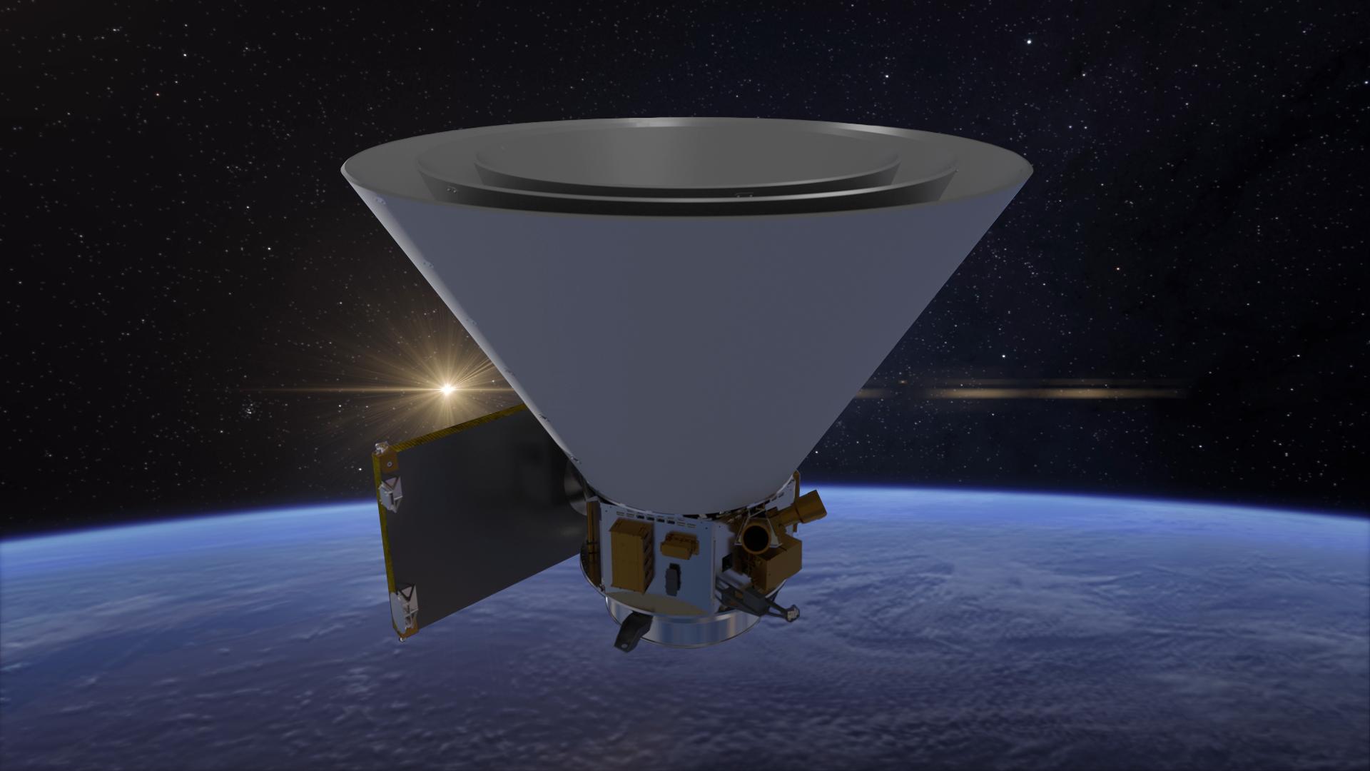

Built by Ball Aerospace with a payload provided by Caltech and NASA’s Jet Propulsion Laboratory (JPL) and test facilities from the Korean Astronomy and Space Science Institute (KASI), the 1,100-pound (500 kilograms) SPHEREx weighs about as much as a grand piano and runs on less power than a kitchen refrigerator. But it promises to pack a scientific punch well above its meager dimensions.
Shaped like an oversized bullhorn, it stands 8.5 feet (2.6 meters) tall and spans 10.5 feet (3.2 m) at its widest — three nested photon shields that surround and protect its delicate optics from the heat and light of Earth and the Sun, as well as from the warmth of the spacecraft’s own making, generated by its computers and electronics.
“The shields are actually quite light and made with layers of material like a sandwich,” said Sara Susca, SPHEREx deputy payload manager and payload systems engineer, in a press release. “The outside has aluminum sheets, and inside is an aluminum honeycomb structure that looks like cardboard — light but sturdy.”
Gaps between the shields and specialized conical mirrors (called V-groove radiators) will expel heat into space, keeping SPHEREx’s temperature below –350 degrees Fahrenheit (–210 degrees Celsius). That helps prevent its own infrared glow from overwhelming the faint light emitted by distant celestial objects.
“We’re not just concerned with how cold SPHEREx is, but also that its temperature stays the same,” said Konstantin Penanen, the mission payload manager, in JPL coverage of the mission. “If the temperature varies, it could change the sensitivity of the detector, which could translate as a false signal.”
The shields guard SPHEREx’s triple-mirror telescope, a 164-pound (74.5 kg) spectrophotometer that will scan the sky across 102 color bands with better resolution than earlier all-sky maps. With an 8-inch (20 centimeters) aperture, a 3.5° by 11.3° field of view, and two focal-plane assemblies housing six photodetector arrays, its lack of moving parts minimizes the risk of failures — but meant its focus had to be precisely configured on Earth to withstand the rigors of launch.
